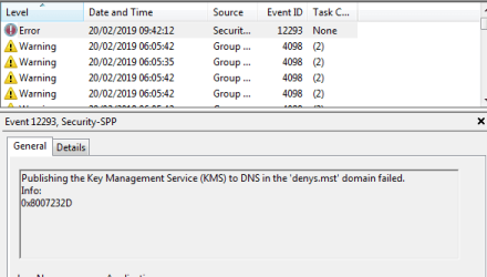

Hi SysAdmin,
The little snippet at the end Home v Domain, could prove very usefull.
When i was looking over the logs there was indeed 1, and only 1, Error message
see screenshot
It appears that it cant contact or reach your server
In one of my earlier posts i mentioned about Internet Zones, and the error code of 0x8007232d kind of backs this up.
Have a read of this, METHOD 5 is the relevant part
Access Denied
(ignore the title it takes you to an MS KMS article- forum problem)
I have a theory as to why its failing
MS published a slightly iffy fix details:zip:
If you look at my post regarding the SPP reset theres a difference
MS ask you to remove the cache data folder I DIDNT, states - leave it alone
Easy to check - compare the Reg data - known good against this comp
Let me know
Roy

</Event>
Could this be the moment that the product key gets "lost"?
