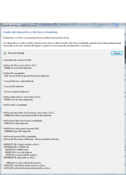

Disk Checher, Only Scan
No problems were found on the device or disk. I'm Italian, and I have an Italian version of Windows7, so I don't know if the log can actually be useful. I put it as a picture anyway.

It has booted into a temporary profile since yours is too corrupt to load.
Try System Restore as far back as necessary.
Then run another MBAM full scan to make sure no infection was restored.
If this fails post back up the MBAM in another file format than .rar which is what pirates use.
We must be absolutely sure it is cleaned up and any specialized tools are used if necessary.
Then you can try creating a new User profile to see how it functions for awhile before moving over your files and deleting the old one.
Or you can try a Repair Install
