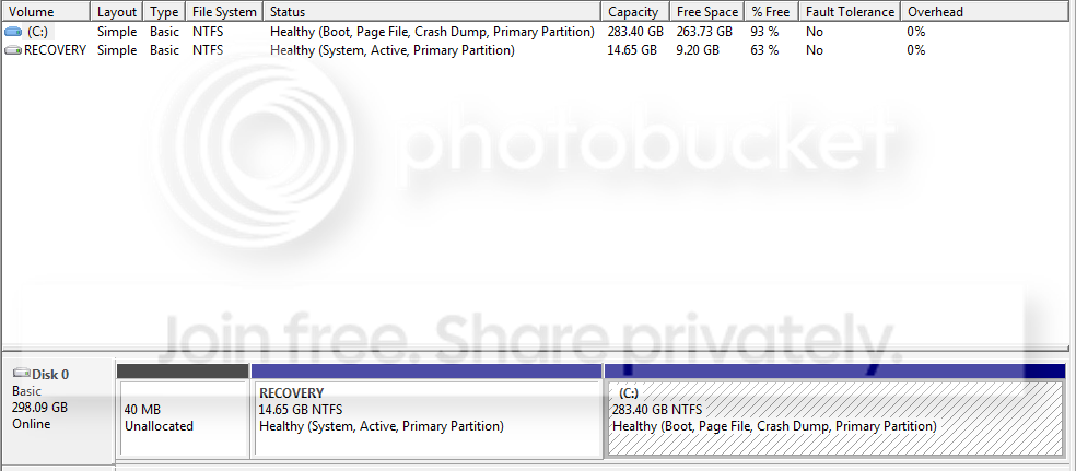

Except what happened was, I had deleted both the OS and system reserved partition which is what the 40mb is from, and I didn't end up with one single unallocated partition/space, I tried to make the larger partition that had prevously had the OS on bigger and use up the 40mb unallocated space, but that didn't want to work, so I had to install the OS on the larger partition leaving the 40mb one doing nothing.
So below is what I have now, I have acronis disk director that I was going to use to add the 40mb back to the OS partition.

Your Recovery is marked System Active which means it contains the critical boot files. This is likely required to boot it should you need to run Recovery - which is the only way it will run now that you've installed Win7 and it's lost its link to Vista.
I would not mess with trying to create a SysReserved partition since your boot files need to remain on the Recovery partition as long as you keep it. In similar cases where System Active has been moved to Win7 partition or its System Reserved boot partition, Recovery would not run even when marked Active again.
What you deleted is a factory OEM partition typically seen on a factory configuration such as yours. There was no System Reserved partition. You could not add that space to Win7 partition because Recovery is in the way. It can be done using free Partition Wizard bootable CD but I would not move the Recovery Partition now unless you decide to delete it.

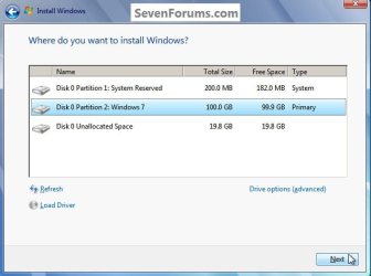

Hello again.
First create the SysResv partition and mark that active, then create a second partition of 100GB to install Windows 7 to selecting that "Windows 7" partition when you get to the "Where do you want to install Windows" dialog box during the install process.
SSD / HDD : Optimize for Windows Reinstallation
Have a look at this first snip for the complete create process, Step Two #3 in the tutorial; and the second for "the where" for the install.
Do not use the installer to format anything, just click to select the Windows 7 partition and click next.
