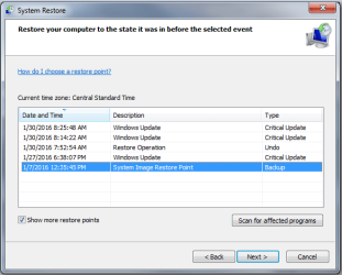

Today, however, I needed to use System Restore due to an issue I was having with multiple monitors that I just couldn't figure out. So, I went into System Restore and found a "Date andTime" of a restore point that was right around the same time I did the Factory Restore. That Restore Point was also the oldest and since I knew it was a known & good restore point, I decided to use it. That restore point "Description" was labeled "System Image Restore Point" and the "Type" was labeled "Backup." (See Image)
I don't recall setting up or doing any backups although, between Windows Backup, Norton Backup and HP's Backup utilities some type of backup obviously happened. FYI, I hate having all those options, as I'd rather use native Windows tools. In any case, today, I used the System Restore using the System Image Restore Point labeled as Backup and, after performing a few minor Windows Updates, everything went off without a hitch and my monitor problem was solved.

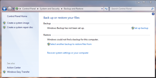

However, seeing that Restore point being labeled as "Backup" I got curious about that Backup so I went into "Control Panel" then "System and Security" and then "Backup and Restore" to try to find the backup, although it was not found by Windows. (See Image)
Questions...
  1. Where is that Backup file and how do I find it? Again, System Restore found it & restored it successfully so obviously it's somewhere.
  2. In System Restore, are restore points labeled as "Type" / "Backup" always saved or are they eventually overwritten.

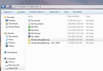

FYI, I did find the original WindowsImageBackup file on my internal hard drive so, what I did was rename the file by adding a date and then created another WindowsImageBackup & system image in Windows 7. That said, I might have figured out a solution within Windows 7, without using a 3rd party software like Macrium, albeit, this is a manual process.
Here are the steps I took...Does this make sense ? ? ?
Step 1 - Rename any prior WindowsImageBackup files you don't want to overwrite.
Step 2 - Click "Create a System Image" & the "Save to" drive location
Step 3 - Verify the drives to be "backed up" and then start backup
Step 4 - Start Backup

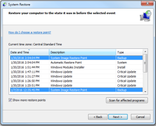

When completed, I now have 2 images saved on my internal hard drive; again, I renamed the original file by adding a date, so Windows would not overwrite it.
Then, in System Restore, both "System Image Restore Points" are still listed...
The only suspicion I have is that if I tried to do a System Restore on the Jan 7th Image/Restore Point, Windows might not recognize it, since it was renamed. However, that really does not matter to me, since I basically took that restored Jan 7th image, installed all Windows updates and then created another full backup & image on January 30th. In other words, the Jan 30th back up is basically the Jan 7th backup, plus any Windows updates & file changes I might have made. Plus, I could probably restore back to the Jan 7th by deleting or renaming the Jan 30th backup and then renaming the Jan 7th file, by deleting the date.

After you renamed the files, can the recovery program still find them.
NO...As I suspected, when I tried doing a System Restore to the older Restore Point (January 7th on my system), I got the following error, assumedly because I renamed that associated backup & image file.
Again, I suspect that this is because the name / format changed for the backup associated with that specific Restore Point. Moreover, I believe the System Restore is looking for the exact file name "WindowsImageBackup" in the exact same file location that was associate with that specific Restore Point. As I mentioned earlier, perhaps if I changed the name of the newer backup and changed the older back up name back to its original name "WindowsImageBackup" it might work, although I'm not going to mess with trying on my system.
Again, I believe the renamed files could be recovered if renamed or saved to a different media (external hard drive or DVD). In fact, Windows Help File states that this is possible when you click on "more information" in the backup window. (See Below)

This is what I thought - there are no simple procedures. And they do not give you a chance to browse for it either. So you are stuck. That's why I like free Macrium. There you can rename or move the restore points and still find them with a browse.
Ok, since you got me curious, I decided to test out the theory of changing the name back on the original backup/image and then trying to use the original Restore Point in Windows 7...IT WORKS ! ! !
I was able to restore my computer back to January 7th, once I changed the file name back. I first changed the newer backup name to WindowsImageBackup - Jan 30, 2016 and then changed the original WindowsImageBackup - Jan 7, 2016 simply back to "WindowsImageBackup." Moreover, after changing the file names, System Restore in Windows 7 correctly associated that old Restore Point back to the original WindowsImageBackup file and my computer returned back to it's earlier state (Jan 7th) absent all of the updates & changes that I'd made.
I was also able to successfully do a System Restore back to January 30th.
