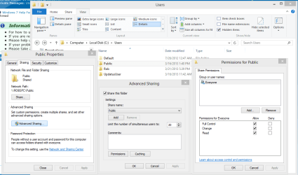

You should first check in the Network and Sharing Center> Advanced Sharing Settings, there are separate settings for the Public folders that must be enabled in order to share the Public folders. You should check to ensure that Network Discovery and Printer and File sharing are both enabled.
You should also make share that the permission settings on the C:>Users>Public folder appear as in the picture. :)

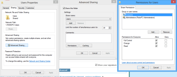

That wouldn't change the router or the subnet, I'm not sure how it would effect the other machines but messing with default file locations isn't advised for obvious reasons.
I can't really see the changes you made and it's pretty hard to guess at it from here but you should make sure that the C:>Users folder is shared out correctly or else the subfolders such as the Public folders won't allow access.

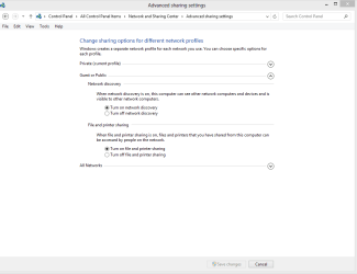

You might want to also check in the Advanced Sharing settings to make sure that the Public folders have network discovery and file and printer sharing turned on "second picture".
