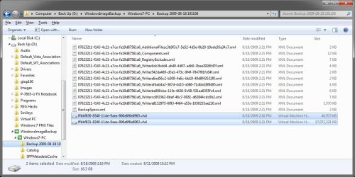

Hello Musiclover,
After you create a system image in Windows 7, you can then use the tutorial below to mount the system image to extract specific files from.
http://www.sevenforums.com/tutorials/24771-system-image-extract-files-using-disk-management.html
All backups in Windows 7 are incremental to only save the changes that were made since the last backup.
Hope this helps,
Shawn
