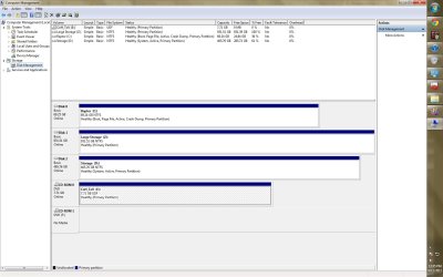

Can you post back a screenshot of your maximized full Disk Mgmt drive map with listings showing all columns, using the Snipping Tool in Start Menu. We can look it over for you.

I think this is what your looking for

Storage drive must have been in one of the lower number slots and marked Active which caused the System boot files to be placed on it. This is not correct and makes your Win7 bootable only if Storage is connected and working.
Best to move the System boot files to Win7 as they should be.
Set Win7 HD as first HD to boot in BIOS setup, after DVD drive.
Boot the Win7 DVD or Repair CD, Use Diskpart to mark D Inactive. Partition - Mark as Active Method Two
Then from the DVD/Repair CD System Recovery Options run Startup Repair up to 3 separate times with reboots until Win7 starts and System flag is now on C.
If this fails you may need to power down to unplug D while the Repairs are run.
You can also use free Partition Wizard bootable CD to have a graphical picture of the HD's: rightclick on D to Modify>Set Inactive, OK. Now highlight the Win7 HD and from Disk tab select Rebuild MBR, Apply all Steps. This may preclude the need to run the Repairs.
Make sure Win7 HD remains first HD to boot and marked Active throughout.
