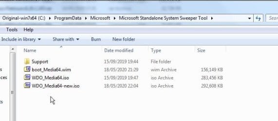

Just checked. the sha2 update is not applicable to the winpe version mssstool64.exe made - at least not the version I had.
It integrates into winpe3.1, but not into the winpe3.0 that mssstool64.exe made a while ago.
edit: just made a new iso - it is a lot bigger than the older one. will do a test
edit - new one also not working :(

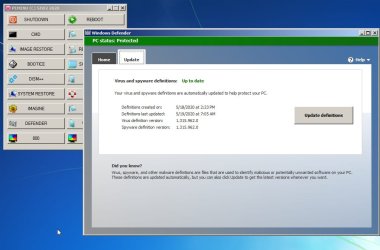

greyrat
I seem to have got it working

Your ISO works for me too. Very impressive boot PE environment. Thx for sharing! Did you end up adding the SHA2 update to your source?
I made that one specially for WDO. It includes support for sha2 , nvme, most usb3 and some extra wired net drivers.
MS say they will keep supplying definition updates for windows 7 MSE till 2023 - presumably WDO will be the same.

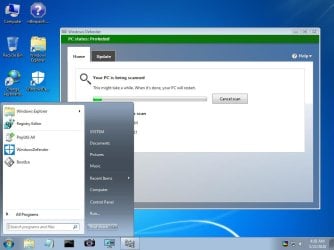

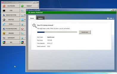

Fancier version of winpe running WDO:
