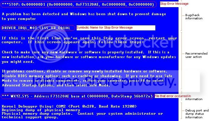

Let us know the info from the BSOD. We'll need the info in RED from this picture:

Rapidly tap F8 just before the Windows Splash Screen shows (when booting)
This'll get you to the Safe Mode menu
Scroll down and look for the entry about disabling automatic restart on system failure.
Select that and the system will stop on the next BSOD and give you time to read it.
