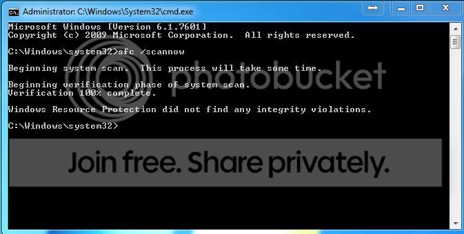

I just uninstalled ASUS ROG Theme and voila:
So now I learned. Where do I get "proper" Windows 7 themes that would not corrupt explorer.exe?
