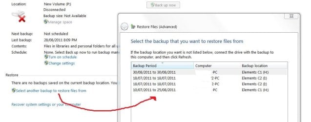

Check this Windows help screenie:

You're correct, mjf, I just want my files and stuff back. The problem is that when I hit the "Select another backup" it pops up a window that scans for backups, and tells me it can't find any. Then, my only options are to "Browse network" and "Refresh" neither of which are of any use to me. (Note attached photo)
The backup is on an external Hard drive, plugged in via USB, and I can see the backup file on it, and access it fine, it's just the backup system can't see it. If I were to remove the HD from the external housing and plug it in via sata, might that help the situation?
