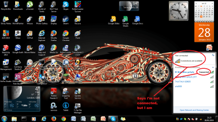

First, windows says i'm not connected to the internet when i actually am.
Adressing the first issue, as seen in the screenie, i'm connected to the internet but Windows says i'm not, this is annoying and means i can't join a homegroup, the screenie shows the regular icon, wired, with the warning symbol, however i have a secure connection, please help with this as i am getting more and more annoyed.
I have attached a screenie showing the issue and i will post more if needed.
Thanks in advance.

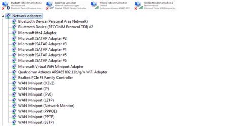

Can you post a screen of the network adapters in sharing center and in device manger. Like this. Are you using any vpn programs on your pc like hamachi?

Here you go, and i used to use hamachi, but i deleted it, and this problem was present for a while before.

Try disabling Wireless Network Connection 2
