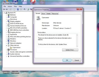

okay...i installed device doctor...it found 2 updates. i updated them and they were installed (i confirmed by re-scaning with device doctor). However, the coprocessor issue isnt solved.
i took a screen shot.
Hp dv6812nr
Windows 7 professional
in "Coprocessor properties" click on "Details" tab next go to "property" and choose "Hardware Ids" and post here hardware ID
