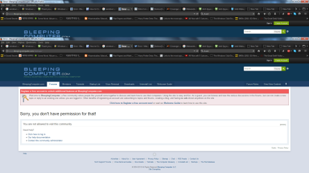

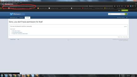

Hello thanks for the reply, well i actually installed Malwarebytes Anti Malware using Chameleon in the first place, and it did find some PUP but failed to find that specific malware which is causing this problem. I ran Malwarebytes Anti Rootkit too which clearly doesn't find any malware or anything :( what can i do ?> :S
EDIT:
As to your next suggestioN i get this page if i try to access any page of those sites T.T

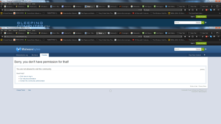

umm Sir u got me wrong. I said i installed the Malwarebytes using the Chameleon in normal boot. It then started scanning and fount some PUP and successfully sent them to qurantine. Then when i restarted the pc it wont open. just blank(black) screen after Welcome Screen. But it does open succesfully in Safemode. If i uninstall Malwarebytes Anti Malware in safe mode only then i can start my windows normally without that blank screen. Also i told u before and i'm saying you again, if i try to access any link u provided in the above reply this page appears. but no problem for any other internet pages unless my ISP bans it(like some illigal fileshaing sites). I Guess it;s some next level MALWARE >.<

Sigh, i told you before, i can't access those malwarebytes forum links u provide. It used to happen previously with Bitdefender too. I Installed the Bitdefender 2014, ran a scan, it detected some keygen nd so on. When i restart the pc it DID BOOT but stuck(with a black screen) after Welcome Screen. But if i remove the Bitdfender using safemode then i can start My windows normally. It's now happening with Malwarebytes. SO i am preety much sure it's due to some malware, dont u? FYI i also ran a system check(that is cmd>sfc /scannow) and it says no files are violeted so u cant actually say that any of system files are damaged due to scan by the Antimalware ENGINE
