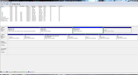

I've attached the image to this post (The partition with Win XP in is not the only logical drive, the drive to the right is also logical) and to answer some things
When I boot directly into my Win 7 duel-boot to load Windows XP, it works fine, only GRUB is giving me this issue
Also, It gives me an error saying that Windows XP couldn't find boot.ini when booted with GRUB, Win 7 is fine
I just found some locked folders on one of my drives (I'm admin on my PC and this wasn't a system drive) so they might be the files to boot Win XP

Will both Windows OS"s boot as now if you unplug the second drive?
If so then I'd keep the GRUB booting only to the second drive when you choose it from BIOS Boot Menu key.
If this isn't to your liking then uninstall GRUB and add your Linux installs from Windows 7 using EasyBCD as described by Barman in Where to install ubuntu in my system?
