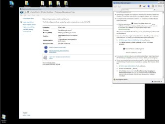

It took around 25 mins, and installed correctly ... however, my troubles remain. Some screenshots are attached, taken after the KB947821 install.
