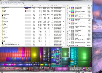

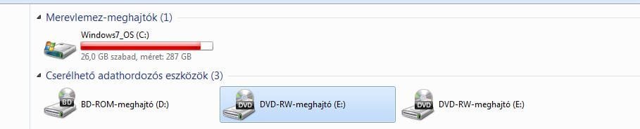

I attach some screenshots about the disk (sorry about the texts, the operating system is hungarian).
Imre

I ran all your numbers through the calculator and can only find about 38GB missing. Some of that could be the MFT and other hidden files as part of the OS.
NTFS.com Master File Table.Fix MFT

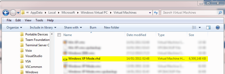

By default XP Mode does not take 127 GB of hard disk space. It is only possible if the user has converted the default dynamic vhd to a 127 GB fixed size vhd.
In Microsoft Virtual PC, the maximum size of a vhd is 127 GB. You can not mount or use virtual hard disks bigger than that. When you create a vhd in Virtual PC, it is by default a so called dynamic disk. This means it only uses as much space on host HD as needed but it is allowed to expand, grow, to that maximum you choose when creating the vhd. For instance, I have created a Windows Vista virtual machine, setting the dynamic size of the vhd to be 50 GB. Currently this vhd is 17.5 GB, taking as much space from my host HD; if I install new programs to this Vista vm, it is however allowed to expand until that 50 GB limit. Vista virtual machine sees this vhd as a 50 GB HD because a virtual machine always sees the HD as big as its allowed maximum size.
XP Mode is a Virtual PC virtual machine. Its vhd is a 127 GB dynamic disk. This simply means that the virtual hard disk of XP Mode is allowed to expand up to 127 GB. This is why if you check the HD size when running XP Mode, it shows its HD is 126 GB (the XP Mode base vhd, which is needed for XP Mode to run reserves 1 GB from total 127 GB). A virtual machine sees the dynamic vhd always as big as its maximum size. However, on host's HD it only uses the space it needs. Here's a quite freshly installed XP Mode vhd, you can see it is only a bit over 6 GB seen from the host:
And here's the same vhd, this time seen from the XP Mode showing 126 GB (maximum size minus base vhd):
You can convert a dynamic vhd to a fixed size vhd. A fixed size vhd is always the same size, also taking exactly that space from host's hd:
Fixed size XP Mode 127 GB vhd | Dynamic XP Mode 127 GB vhd
Takes 127 GB of host HD space|Takes anything from 5 GB up to 127 GB of host HD space
Is seen to XP Mode as a 126 GB HD |Is seen to XP Mode as a 126 GB HD
