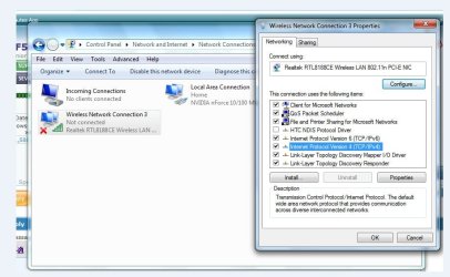

Can you post some screenshots of the settings you're looking at? Also post a screenshot of ipconfig /all output.
Attached screenshots. The IPv4 and IPv6 are both set to auto detect in the properties.
Thanks!
