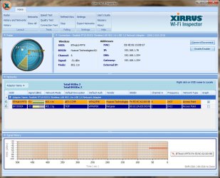

The open network that is using the same channel as your router is a big problem.
The signal strength is the same and they are both on the same channel 6 which can only create problems. Is this some sort of guest network from your own router?
In either event the guest networks using the same channel as the regular network has been causing problems on a fairly constant basis. I've seen this multiple times with the same complaint, about signals dropping, streaming won't work etc. which is to be expected when two channels are overlapping so completely.
The real problem is that the ISP's in their infinite wisdom, don't seem to think this will cause any problems, I can assure you that the opposite is true and overlapping signals like I'm seeing here will cause problems every time without fail.
The channel needs to be changed to either 11 or 1 on the main router or the guest network needs to be disabled in order to fix the problem.
I have no idea about these powerline networking deals so can't help with that but the those two wireless signals crossing over will cause problems such as you are seeing.

Ah thanks for the tip with the guest network, after some Googling it seems to be BT Hub's open Wifi network, which I now opted out from and should stop service in 48 hours. I hope this will sort out the horrible speed, I guess I will see :/

The open network is still there, but what's weird is that sometimes the internet is actually fast, but then it soon returns to the horrible slowness.
Like today I measured
42.07 Mb/s download and 17.33 Mb/s upload around 1pm, then
0.81 Mb/s download and 4.44 Mb/s at 4pm, and now it's
35.29 Mb/s download and 18.33 Mb/s upload again at 5.30pm.
I don't understand what causes the wild swings in speed :/ (I'm obviously not using the network when measuring the speed.) But if it's technically capable of being fast (as it was in the past as well), then what causes it to slow down again? Is it possible that someone is using our bandwidth from the outside? Or something else?

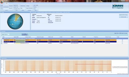

Ok the open network is gone but the download speed is still ~0.85 Mb/s most of the time. BT support said that they can connect to my hub with 73 Mbps, so the error is on my end and their only advice was to buy a wireless booster. Anyone has any (free or at least cheaper than £50 that those cost) idea that could sort this out?
My Wi-fi Inspector looks like this at the moment:

That is too much change in wireless speed I agree although it's hard to nail down a problem that seems to be so intermittent.
I don't think a booster or repeater would help at all because those only amplify the signal coming from the router at the expense of cutting the bandwidth in half and the signal strength is good enough as is with zero interference from the neighbor who is also on a different channel.
I can't say if the wild swings are caused from the machine or the BT Hub and I've never really heard of a driver causing a problem like this. In either event I would try using a different router or modem and see if anything changes.
