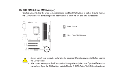

Anytime you think you might be dealing with a IRQ problem the first step will always be to do a ClearCMOS procedure. This will reset the BIOS and force it to re-enumerate all of the connected devices, usually correcting any bus conflicts.
CLRTC/ClearCMOS/CLR_CMOS Procedure:
  • Note all your current BIOS settings
  • Shut down the computer > remove the power cord.
  • Remove the 3v battery.
  • Move the CLRTC jumper from pins 1-2 to 2-3.
  • Touch a metal part of the case and Press and Hold the reset button for approx. 30 seconds to discharge all power from the board.
  • Put the CLRTC jumper back on pins 1-2.
  • Replace the 3v battery > replace the power cord > boot.
  • Immediately go back into BIOS and reset BIOS Defaults and then reset all your preferred settings.
  • If the CLRTC worked you will need to reset the date and time.
Your motherboard is a little different in procedure:
See if that helps
