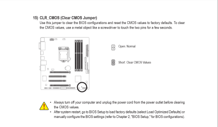

Your motherboard is a little different in procedure:
See if that helps
