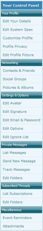

Ok, this is weird, I don't have that option in the CP. :cry:
