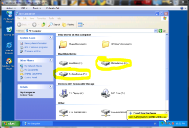

I don't think so. When you mount an external device, it is no longer available to host. It is really installed as a new device directly, and is thereafter seen as an internal drive, not network drive, thus making copying and moving faster. This image tells it better:

I know the USB devices acts as builtin devices, but that still could use tcp/ip as underlying transfer protocol, just like some orher remote USB devices.
Of course, if you check the transfer speed, if it is much faster than network (e.g., a few Mbps), then you are right, and they must be tunnelling through direct vm/host ports.
