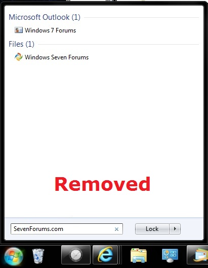

EXAMPLE: "See more results" link Added or Removed
NOTE: This option will affect all users on the computer.
OPTION ONE
To Add or Remove "See more results" Link using a REG File Download
