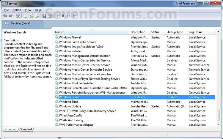

    4. Right click on the service you want to disable or start and click on Properties. (See screenshot below)
    5. To Disable a Service
    NOTE: See the guide in the TIP box at the top of the tutorial to help decide.
    A) Click on the Stop button and wait a sec for the service to stop. (See screenshots below step 7)
    B) Next to Startup type, click on the drop down menu and select Disable. (See screenshots below step 7)
    C) Click on the Apply button. (See screenshots below step 7)
    NOTE: If the service will not stop and gives a error, then you will need to restart the computer to stop it after you set it to Disabled and clicked on OK.
    D) Go to step 7.

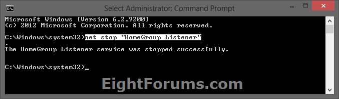

    2. To Stop a Service using "Net Stop" Command in Command Prompt
    A) In the elevated command prompt, type the command below, press Enter, and go to step 4 below.
    NOTE: The Display name of a service is the name displayed in the Services snap-in window, and in the service's properties.
    net stop "service name"
    OR
    net stop "display name of service"
    For example:
    If I wanted to stop the HomeGroup Listener (display name) or HomeGroupListener (service name) service, I would type either command below exactly in the command prompt, and press Enter.
    net stop "HomeGroup Listener"
    OR
    net stop "HomeGroupListener"

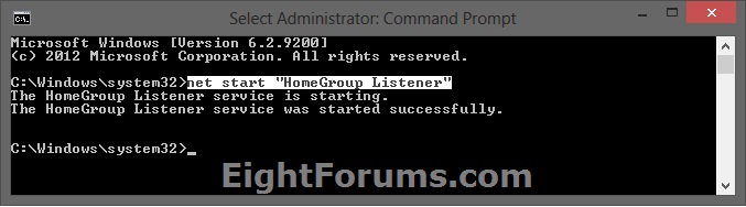

    3. To Start a Service using "Net Start" Command in Command Prompt
    net start "service name"
    OR
    net start "display name of service"
    For example:
    If I wanted to start the HomeGroup Listener (display name) or HomeGroupListener (service name) service, I would type either command below exactly in the command prompt, and press Enter.
    net start "HomeGroup Listener"
    OR
    net start "HomeGroupListener"

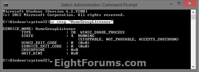

    2. To Stop a Service using "Sc Stop" Command in Command Prompt
    A) In the elevated command prompt, type the command below, press Enter, and go to step 5 below.

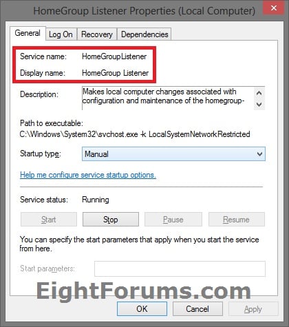

    NOTE: The Service name of a service is displayed in the service's properties.
    sc stop "service name"
    For example:
    If I wanted to stop the HomeGroup Listener service, I would type the command below using the HomeGroupListener (service name) exactly in the command prompt, and press Enter.
    sc stop "HomeGroupListener"

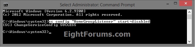

    3. To Disable a Service using "Sc Config" Command in Command Prompt
    A) Do step 2 above to stop the service.
    B) In the elevated command prompt, type the command below, press Enter, and go to step 5 below.
    sc config "service name" start=disabled
    For example:
    If I wanted to disable the HomeGroup Listener service, I would type the command below using the HomeGroupListener (service name) exactly in the command prompt, and press Enter.
    sc config "HomeGroupListener" start=disabled

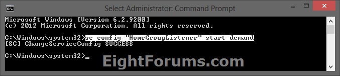

    4. To Start/Enable a Service using "Sc Start" & "Sc Config" Commands
    A) If the Startup type of the service is set to Disabled, then in the elevated command prompt, type the command below using the startup type you want to set instead, and press Enter.
    sc config "service name" start=demand
    or
    sc config "service name" start=auto
    or
    sc config "service name" start=delayed-auto
       Note
    "Startup Type" for Service
    • Manual (demand) - Manual mode allows Windows to start a service when needed. However, very few services will start up when required in Manual mode. If you find you need a service, place it into Automatic.
    • Automatic (auto) - With a service in this state, it will start at boot time. Some services, when no longer required, will also automatically stop when not needed. If you find you do not need a service, place it into Manual or Disabled.
    • Automatic (Delayed Start) (delayed-auto) - With a service in this state, it will start just after boot time. Some services, when no longer required, will also automatically stop when not needed. If you find you do not need a service, place it into Manual or Disabled.
    For example:
    If I wanted to set the startup type for the HomeGroup Listener service to Manual, I would type the command below using the HomeGroupListener (service name) exactly in the command prompt, and press Enter.
    sc config "HomeGroupListener" start=demand

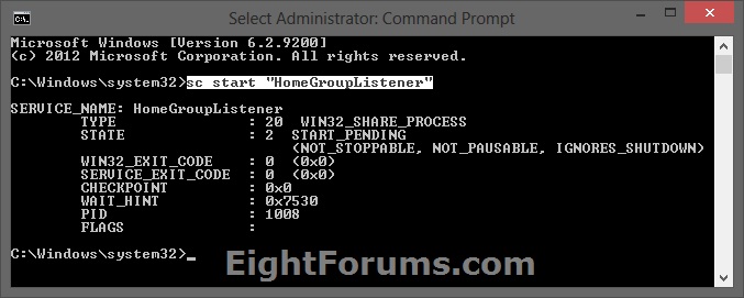

    B) In the elevated command prompt, type the command below using the same service name from step 4A above, press Enter, and go to step 5 below.
    For example:
    If I wanted to start the HomeGroup Listener service, I would type the command below using the HomeGroupListener (service name) exactly in the command prompt, and press Enter.
    sc start "HomeGroupListener"

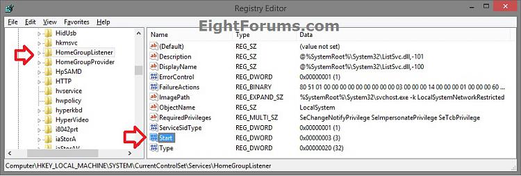

    OPTION FOUR
    To Start, Stop, and Disable Services in Registry Editor
    1. First, open services.msc and double click/tap on the service to see what the "Service name" is for the service. This will be the name of the registry key for the service in step 4 below.
    2. Press the Windows + R keys to open the Run dialog, type regedit, and press Enter.
    3. If prompted by UAC, then click/tap on Yes.
    4. In Registry Editor, go to the location below: (see screenshot below)
    NOTE: Substitute Service name in the location below with the actual service name from step 1 above.
    HKEY_LOCAL_MACHINE\SYSTEM\CurrentControlSet\Services\Service name
    For example: The "Service name" for the HomeGroup Listener service is HomeGroupListener, so I would go to this location in the registry.
    HKEY_LOCAL_MACHINE\SYSTEM\CurrentControlSet\Services\HomeGroupListener
    5. In the left pane of the Service name (ex: HomeGroupListener), double click on the Start DWORD to modify it. (see screenshot below)
    6. Type in a data value from the table below for what you would like to do, then click/tap on OK. (see screenshot below)
    Startup Type DWORD "Data" Value
    Automatic (Delayed Start) DelayedAutostart = 1
    Start = 2
    Automatic DelayedAutostart = 0
    Start = 2
    Manual DelayedAutostart = 0
    Start = 3
    Disabled DelayedAutostart = 0
    Start = 4
    7. If needed, double click on the DelayedAutostart DWORD to modify it's data value (0 or 1) to what's in the table above for what you want set, and click/tap on OK. (see screenshot below)
    NOTE: If the DelatedAutostart DWORD is not there, then you can right click on an empty area in the right pane, click on New and DWORD (32-bit) Value, type DelatedAutostart, and press Enter to add it. If DelatedAutostart is not there, then it will be the same as it being set to 0 (zero).
    8. When finished, close Registry Editor, and restart PC to apply.
