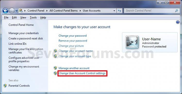

1. Open the Control Panel (icons view).
2. Click on the User Accounts icon.
3. Click on the Change User Account Control settings link. (See screenshot below)

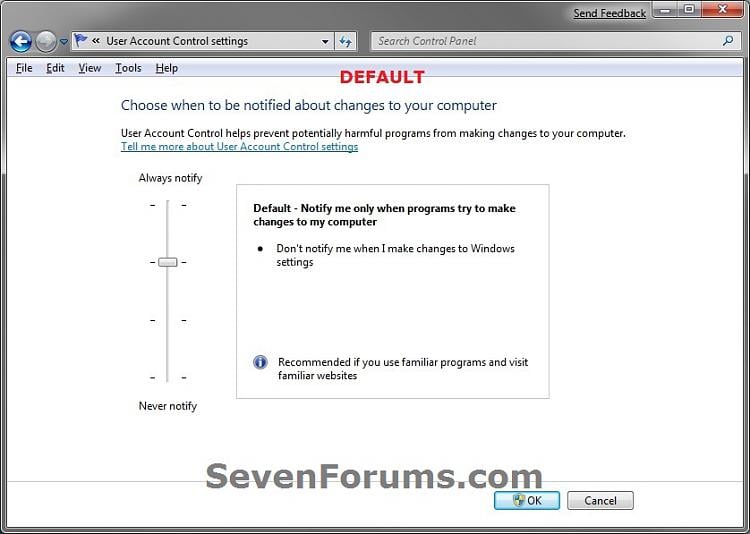

2. To Have the Default UAC Notification
NOTE: This is level 2. See the second screenshot under step 6 in METHOD ONE. This will only notify you when programs try to make changes to your computer, and not when you make changes to Windows 7 settings.
A) Click on the Download button below to download the file below.
UAC_Level-2_Default.reg
Download
B) Go to step 5.

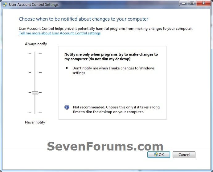

3. To Have UAC Notify without Dimming Desktop
NOTE: This is level 3. See the third screenshot under step 6 in METHOD ONE. This will only notify you when programs try to make changes to your computer without dimming the desktop, and not when you make changes to Windows 7 settings.
UAC_Level-3_No_Dim.reg
Download
B) Go to step 5.

3. To Have UAC Notify without Diming Desktop -
NOTE: This is level 3. See the third screenshot under step 5 in METHOD ONE. This will disable (turn off) UAC completely. You will not be notified of any changes made by program or you to Windows 7 settings.
(1) I couldn't figure out what "Diming" meant and thought I must be falling behind on the latest slang... ...until I looked closely at the images and realized you meant "Dimming." ;)
(2) I downloaded the images for future reference, but the Level 3 image is named "Default.jpg," while the Default UAC Notification (Level 2) image with "DEFAULT" superimposed on it is named "Always_Notify.jpg"
(3) Both the text in the Level 3 image and the Level 3 heading ("To Have UAC Notify without Diming Desktop.") seem to contradict the Level 3 description ("This will disable (turn off) UAC completely. You will not be notified of any changes made by program or you to Windows 7 settings"). If I'm understanding the text presented in the Level 3 image (currently incorrectly labeled as "Default.jpg"), it seems that Level 3 disables desktop dimming only, and leaves notification of changes made by programs enabled.

Oh my. I must have been half asleep with those mistakes. Thank you for pointing them out. They have been corrected. :o
