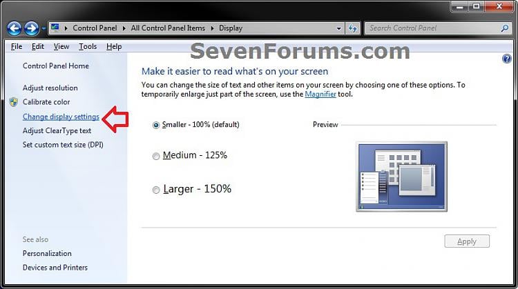

3. Open the Control Panel (icons view), and click on the Display icon. Next, click on the Change display settings link in the left pane. (see screenshot below)Display.jpg
A) Go to step 4.

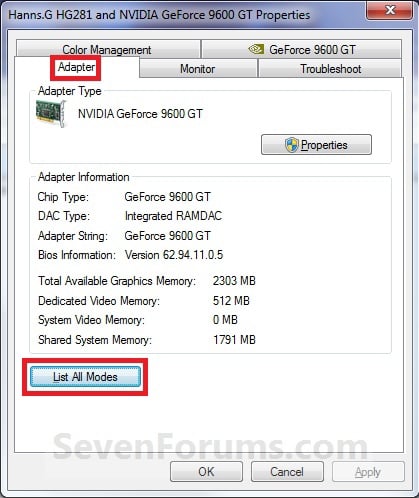

6. To Select from a List of All Display ModesA) Click on the Advanced settings link. (See screenshot below step 5B)
B) Click on the Adapter tab, and on the List All Modes button. (See screenshot below)Adapter1.jpg
C) Select the display mode with the screen resolution, color depth, and screen refresh rate that you want to use, and click on OK. (See screenshot below)
NOTE: It is recommended to use a native screen resolution with a True Color (32-bit) color depth.Adapter2.jpg
