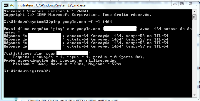

Very interresting...i mean the command...I done the ping and got the value 1464 then add 28 and got the original value i did settle since i've got XP = 1492...(the normal setting!)
Thank you it had confirm my first ping parameter i'd set online, few years ago with an optimizer tool.
