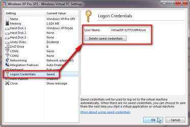

I notice that my image of the properties of the virtual machine, as you have pasted an image in your last message - I have
noticed that in my copy, the "logon credentials" is "NONE" - and I do not see a way to add one at this screen.
Based on a particular brief passage in one of the many documents MS has in the knowledgebase for virtual systems, I have gone into my users from the control panel and added a remote user with a specific credential for the identification of the virtual session:
WINDOWS CREDENTIALS: titled, VIRTUALXP-22741, with these parameters:
internet or network address: VIRTUALP-22741 , user name XPMUser, and a password, persistence set to Enterprise
I also set up one as a "generic credential", same thing, and a second generic one with "virtualapp/didlogical" as the internet or network address, user name of 02gfnpzphdrb, a password, and persistence to the Local Machine.
Is there another way to add a user to the virtual machine so that it won't go to that screensaver dialogue? I'm suspicious that this is dependent on it all.

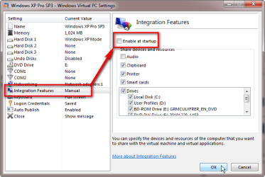

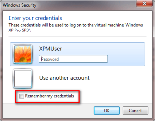

Your XP Mode settings showing no saved credentials is normal. If logon credentials are saved, you can only delete, not save them from settings:
You can only save credentials when logging in to XP Mode when integration features are enabled, in which case there's an option to save logon credentials when starting XP Mode:
If automatic integration is disabled, you get a normal XP logon dialog which does not allow saving credentials:
You can add users to XP Mode only from inside XP Mode; you can not add any users to XP Mode from your host's Control Panel > Users. That part of your post I can not understand, could you please post the link to this MS page that told you to do so.
XP Mode does not go to a screensaver dialog. Never. XP Mode screensaver is permanently disabled. If it were enabled it could cause problems when you launch a virtual XP Mode application from your Windows 7 Start Menu to run on Windows 7 desktop, then let it be unused long enough for XP Mode screensaver to start.
Your issue is either a forgotten or non existing password. Remember that to log in to XP Mode with an account which does not have a password is only possible when automatic integration is disabled.

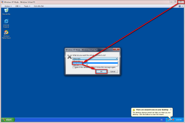

  1. Close XP Mode
  2. Check that your XP Mode is really shut down and not just hibernated (default closing action)
  3. Go to your user folder, double click folder Virtual Machines to open it
  4. Check the machine status of XP Mode:
  5. If machine status is Running, you have not closed it yet. Close it now
  6. If machine status is Powered down, continue from step 8
  7. If machine status is Hibernated, launch XP Mode again and this time shut it down. If you do not manage to shut down XP Mode, you can also shut it down manually by deleting the hibernation data which forces XP Mode to completely reboot next time it's launched. To delete hibernation data manually, do this:

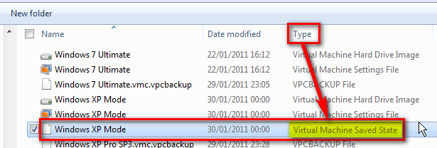

    • Close XP Mode which by default causes it to hibernate
    • Copy and paste the text in the box below to Explorer addressbar and press Enter:
      %userprofile%\AppData\Local\Microsoft\Windows Virtual PC\Virtual Machines
    • This opens your Virtual PC Virtual Machines folder. Now delete the file Windows XP Mode.vsv. The .vsv file contains all XP Mode hibernation data, it does not exist when XP Mode is shut down
    • If you do not see the extension .vsv, look under Type column; the .vsv file type is Virtual Machine Saved State. That's the file you need to delete:
    • Please notice that when manually deleting the hibernation data, the machine status as told above in step 4 still shows Hibernated. You do not need to care about this; the machine status is only updated when you launch XP Mode next time

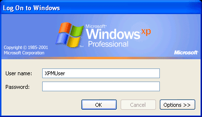

  8. Go to XP Mode settings and check that automatic integration is not selected. If it is selected, unselect it and click OK to save settings (check the image in my previous post)
  9. Launch XP Mode
  10. You are now shown the classical XP logon screen (see earlier in this post, third image from beginning). Username XPMUser should be there already, if not type it to User Name field. Try to remember if you set a password when you installed XP Mode and type it to Password field. If you think you have no password, leave the password field empty and click OK
  11. If the login is OK and you can enter XP Mode, go to XP Mode's Control Panel and add a password to XPMUser account, or create a new user account with password. After that, you can re-enable automatic integration from XP Mode's settings
  12. If the account has a password but you entered it wrong, or if there is a password even you think there's not, you get an error message:

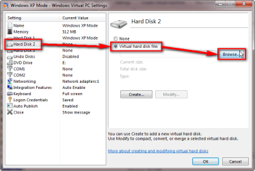

OK, here we go.
If you still have the original XP Mode vhd containing your database, do as told below. Follow the instructions exactly as written, in my opinion this is your best shot to recover the database and be able to continue working with it in XP Mode.
  1. Move the Windows XP Mode.vhd file which includes your database to a safe location, outside it's default location %userprofile%\AppData\Local\Microsoft\Windows Virtual PC\Virtual Machines. Rename it to something else, for instance XP Mode_Backup.vhd
  2. Uninstall XP Mode (Control Panel > Programs)
  3. Reinstall XP Mode. Please notice there's no need to reinstall Virtual PC, only XP Mode

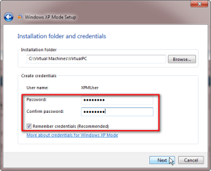

  4. When setting up XP Mode after reinstallation, be sure to add a password and write it down ;)

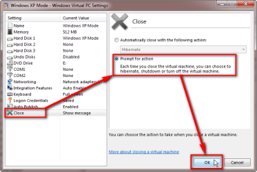

  5. When XP Mode is started first time, let it stay open and go to XP Mode settings
  6. Select Close, select Prompt for action, click OK to save settings
  7. Close XP Mode, select Shut down from closing dialog which you enabled in previous step, click OK to shut down
  8. Open XP Mode settings

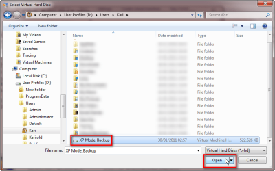

  9. Select Hard Disk 2, select Virtual Hard Disk file, click Browse (Notice: this can only be done when XP Mode is shut down instead of the default closing action Hibernate. That's why steps 6 and 7 were so important!)
  10. Browse to location where you saved the backup vhd, select it and click Open
  11. Click OK to close settings
  12. Launch XP Mode

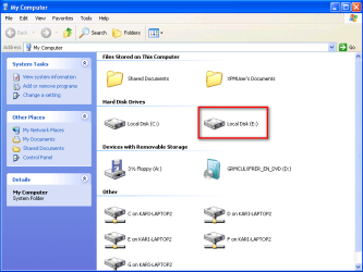

  13. Your backed up original vhd should now be seen as disk E: in XP Mode. Browse it, you should be able to find and recover all your personal files from the old XP Mode, including your database

I had been mapping a drive letter from within the xp virtual machine, to the "tsclient\c", so that I could write out of the virtual machine into the "real world" pc drive some important data that was then incorporated into a MS publisher document template via a macro, to create a "record certificate" for an archer that had set a national or world record. It occurs to me that I could probably do more maps, and then create shortcuts on the desktop, so that the entire set of data records existed on the "real" drive all the time. That would make it more readily available in the future, especially if something went south....
But your suggestion to make the second drive letter point to the old ("good") virtual database space, worked perfectly. First thing I did was to copy and paste ALL the folders to the new virtual machine, so I have essentially TWO copies of the important data....then I recreated some desktop shortcuts that established the right memory provisions and emulation rules. YAYYYYYYYYY!
I am back up and running, and have caught up on a lot of registrations I had fallen behind on! The tournament will be saved!
