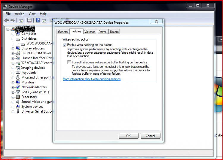

Can you post your hard disk Policies settings in Win7?

yeah its the same as the one you posted on both my drives
