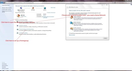

Check the screenshot below on choosing a home network.

Looking at your screenshot you need to look under Unidentified Network and change from a Public Network to a Home Network as I showed you in the screenshot I originally posted.
Next, click Connect to a network if need be, but I think changing to a Home Network may be enough.
If not, click Change Adapter Settings in the Network & Sharing Center and disable the network adapter then enable it again.

@seavixen32 i cant click on the unidentified network to change it from public to home.
