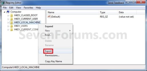

3. To Export a Registry HKEY Branch
NOTE: This will allow you to backup the entire selected HKEY branch with all of it's subkeys and key values to a .reg file as a backup.
A) Right click on a HKEY branch that you want to backup, and click on Export. (See screenshot below)
B) Select where you want to save the exported .reg file to, type in a name for the .reg file, and click on the Save button. (See screenshot below)

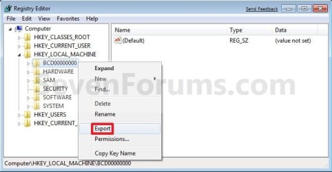

4. To Export a Registry KEY Branch
NOTE: This will allow you to backup the entire selected KEY branch under a HKEY with all of it's subkeys and key values to a .reg file as a backup.
A) Right click on a KEY branch under the HKEY that you want to backup, and click on Export. (See screenshot below)
B) Select where you want to save the exported .reg file to, type in a name for the .reg file, and click on the Save button. (See screenshot below step 3B)

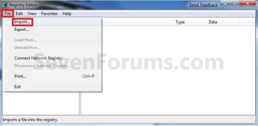

2. Import from Regedit
A) Open the Start menu and type regedit in the search line, then press Enter. (See screenshot below)
B) If prompted by UAC, click on Yes to approve.
C) Click on File on the menu bar, then click on Import. (See screenshot below)

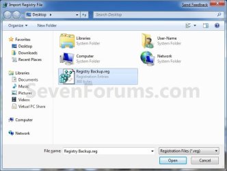

D) Navigate to where you saved the backup .reg file and select it, then click on the Save button. (See screenshot below)
E) You will now see the import progress window. (See screenshot below)
3. Click on OK.
