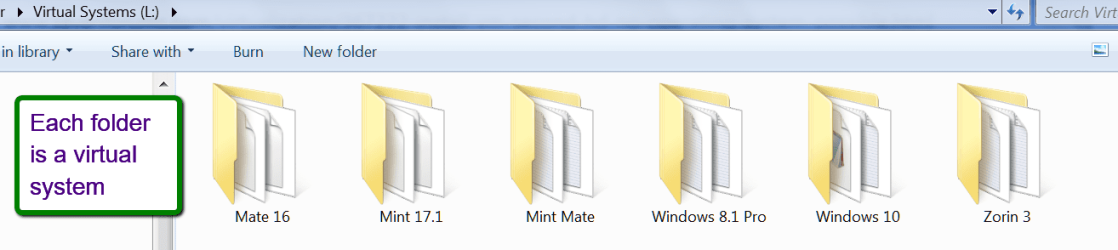

What you can do is to have e.g. VMware Player installed with the OS but then put the virtual systems on the other disk. Each virtual system is just a folder. I run 6 virtual systems that way from an external SSD. Here is a tutorial on how to install and operate those systems.
Thank you! I had chores to do today but now i'm back on the project. I think i got it just like you said, installed VM on my c:drive and made VM folders on my external SSD.
