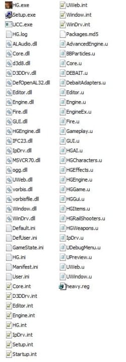

That solved the configurator executable (heavy.exe) but after that either it's uncontrollable (no response after pressing Esc or Enter, as they're basically intros), then (if pressing such buttons works) the main program (HG.exe... which is called "LaunchRes" in the task manager) stucks at 5mb or used RAM (no CPU usage). Manually executing HG.exe gives the same result, while on XP machine it goes smooth both ways (by configurator and main executable). I just disabled DEP mode anyway, so any future exception won't be necessary...
This is the System folder of the game, no use posting the previous directory as it basically contains game folders and the heavy.exe configurator.
