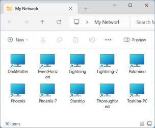

I assume you are trying to access your computer using File Explorer > Network. Since that is problematic with Windows 10 and 11 I don't depend on that. I created a folder on one computer's desktop called My Network. In that folder I placed shortcuts to each computer on my network. A computer's shortcut is \\ + ComputerName. For example, the shortcut to computer DarkMatter is \\Darkmatter. When done I copied that folder to the desktops of all my computers.
Here is what the folder My Network looks like on my Windows 11 laptop. Note the computers are a mix of Windows XP, Windows 7, Windows 10 and Windows 11.
