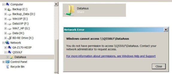

It was a long time ago that I once configured a drive share to another computer.
I know a little bit more than nothing about network, so please explain as you do for normal people.
I have a laptop with Win 7 Pro that is my backup computer and I eventually travel with it.
I removed the ODD and replaced with a caddy to hold a HDD and on the HDD slot I have installed a small SSD for Windows and programs. I also moved C:\users (SSD) to D:\users (HDD).
So D: isn't only a data drive as \users is a system folder.
Only user is D:\users\Luiz
I also have a desktop with Win 7 HP. I want to access the laptop D: drive (read and write) so I can synchronize files and folders.
Only user is D:\users\Backup
From the Desktop I can see the laptop (Q550LF) but it says I don't have the permissions.
How to set the permissions so I can map the D: drive on the Desktop?

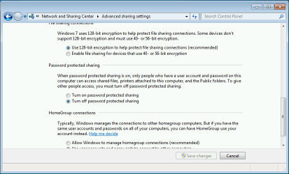

If you are not that concerned about security, then you can set the Sharing permission for Everyone to have Full control. However, you will still be subject the NTFS permissions on that drive. To have full access you will need to add the Everyone group to the drive's permissions and grant it Full control. You should also turn off Password Protected Sharing in the Network ans Sharing Centre.

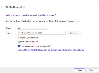

Then when connecting from Laptop to the share on Desktop you need to connect as a user Backup with the correct password for that user account on Desktop. The easiest way to make sure you are doing so is the be signed into an account on Laptop that has the name Backup with the same password as the account on Desktop.
If the password differs, or you are signed in with a different account name, then you will have to connect using different credentials. Then supply the username and password of the local account on the PC you are connecting to.

- On the Desktop I disconnected the mapped drive and reconnected using "Connect using different credentials" and supplied the password of the local account on the Laptop.
For what I see, it is a security violation. To give access to a drive or a folder, the Desktop user has to know the laptop user password. Makes no sense.
