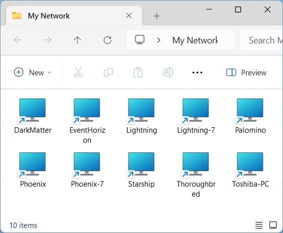

I assume you are trying to access your computer using File Explorer > Network. Since that is problematic with Windows 10 and 11 I don't depend on that. I created a folder on one computer's desktop called My Network. In that folder I placed shortcuts to each computer on my network. A computer's shortcut is \\ + ComputerName. For example, the shortcut to computer DarkMatter is \\Darkmatter. When done I copied that folder to the desktops of all my computers.
Here is what the folder My Network looks like on my Windows 11 laptop. Note the computers are a mix of Windows XP, Windows 7, Windows 10 and Windows 11.

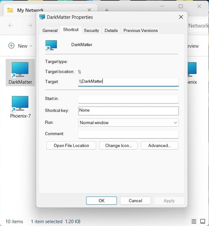

I assume you made shortcuts like this

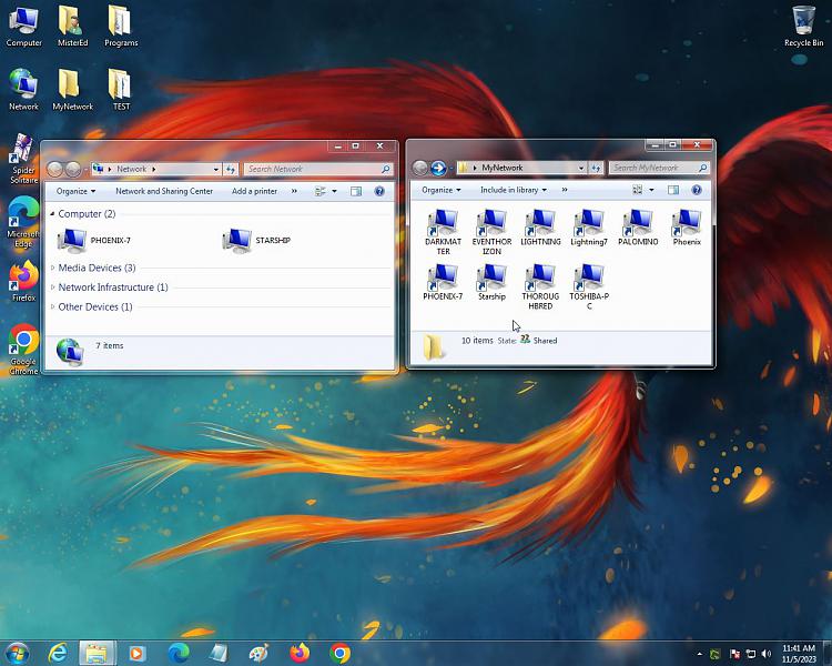

Here is a screenshot I made on my Windows 7 computer Phoenix-7. Note that in Network I can only see 2 computers. However, if I click on the shortcut of any of the computers turned on in the list above I can access their shares.
