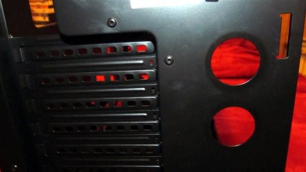

I thought I did (but, then again, I'm old and going senile). This is what I said earlier:
I have plenty of blank covers to replace the ventilated covers, although only one or two will remain uncovered when I migrate my computer into the case. I put in one of the blank covers yesterday to make sure it would do the job.
I'm still mulling over how to seal up the other (stupid) holes on the back of the case. Six of them have a flange bent in so they will have to be cut off (thank God for Mr. Dremel and his little tool). After that, I haven't decided yet how to fill the holes in or cover them. Options I've been mulling over include:
1. Soldering a thin, steel backing plate (mayhap shim stock) behind the hole and filling the remaining depression with Bondo (auto body filler) or body solder (the backing plate would get covered by acoustic foam so no one would ever see it).
2. Gluing a backing plate of thin steel behind the hole with epoxy and filling the remaining depression with Bondo.
3. Screw or rivet a trim strip on each side to cover the holes (actually, this one just now occurred to me). If I prepainted the strip, it might spare me having to repaint the entire back. Curiously enough, I have a length of 1/8" x 3/4" aluminum left over from when I was building my present machine. I needed a 1/8" x 1/4" x 6" piece to cover some holes at the ends of the PCI covers. The closest I could find was a 4' length of 1/8" by 3/4" aluminum so I had to cut what I needed from it. I would have to cut recesses in the back to clear the rivets that would otherwise be in the way. Unfortunately, I would still need to fill or cover the two large round coolant hose openings on the back and the big square hole at the top of the back for the USB pass-through cables.
Right now, option number 2 is in first place.

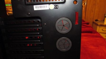

I found a way to seal the two large round holes on the back of the case that currently have the rubber grommets in them. I just found and ordered some flat polyethylene plugs at McMaster-Carr online that are a perfect fit for those plugs. Had to order a hundred of them (mutter, mutter) but they aren't all that expensive and they are a sanitary way to deal with those holes. And I will never run out of plugs!

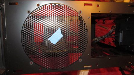

I've been agonizing over what to do about the rear fan grill. Options included:
Ignoring it and the half dozen or so holes that wouldn't be covered by the 140mm fan I'm putting in. While that is the easiest option, it would be the noisiest and would move the least air.
Somewhat better would cutting a 120mm hole in the grill and put a 120mm wire grill over it. It would look a bit dorky but it would cut noise down a bit and move some more air.
The next option, cutting a 140mm hole in the grill and putting a 140mm wire grill over it would look even dorkier and would be a bit more work. So far, all options still have some leaks because the top and bottom rows in the stock grill fall outside of even a 140mm fan and the raised portion of the grill makes it harder to get a good seal.
The option I just settled on tonight involves cutting out the entire raised portion of the grill plus any remaining part of the case that would fall inside of the perimeter of a 140mm fan, then cover everything up with a milled aluminum grill.
I'm going to cut out the "gun sight" in the center and replace it with a wire grill. The center looks really nice but leaves too much room for fingers to get in. I'm on an aspirin regimen and I bleed pretty profusely from cuts. I once half cut, half tore off most of a thumbnail and had to go to the emergency room to get the bleeding stopped. Even they had one heck of a time stopping it, finally resorting to what is basically superglue. A wire grill is safer plus I'm going to be using wire grills on the top so all three will look the same. I'll have to cut a couple of millimeters off the left and right sides. One bonus is two of my problems holes will also get covered up. This option is the most sanitary one I could come up with and gives the best airflow and lowest noise with the least amount of work.

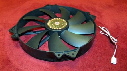

I also found out I can run the 200mm CM Mega flow fan off one of my MOBO fan headers with no problems. I'm still trying to find out from Xigamatek how much current the fan of theirs I want to use will draw. If push comes to shove, I may have to use a powered PWM fan splitter on the two side fans and another one on the two top fans. One thing I may try is to run a fan off my spare PSU through various size fuses to see which size blows. Theoretically, I can run up to 1A on a fan header but I would rather not push the limits. A powered PWM hub supplies power to the fans from its own PSU cable and only gets the speed and PWM signals from the MOBO hub. The only one I know of is Swiftech's 8 port PWM hub. It's overkill since I would run only two fans off each one of two hubs bit I may not have a choice.
