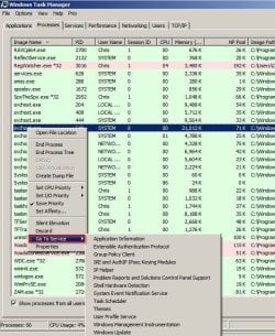

Get the PID of the problematic svchost.exe process (586 in your screenshot
Run Task Manger and right click on the matching svchost process and choose "Go to service"
Let us know which services are running under it.
If Windows Update shows up it's likely to be the culprit. You can confirm by stopping Windows Update Service via Start> Run> services.msc
Stop then set startup type to disabled and reboot to test.

Thanks for the response. Getting a bit late now so will get to it tomorrow. Jusy one point there isn't a PID 586 in my screenshot. Did you perhaps mean "356"?
EDIT: Had a quick look using Process Explorer and there is a Windows Update process in there . Will look again tomorrow as it is not showing high at the moment

Yes, sorry. I meant svchost.exe PID 586 PID 356 in your screenshot. The process might use a different PID next boot.
svchost is how windows groups running services together and assuming that you do not have an unsigned malware process disguising itself as svchost.exe - the problem is likely to be with one of those services.

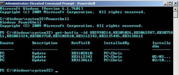

Well that confirms that you've got the windows update high svchost.exe RAM usage problem. Solving the problem might not br straightforward. Many users report that installing some version of WU Client solves the issue.
If you could possibly take a look at which Windows Update clients are installed it would help. Then for the last couple of months there have been other updates that also need installing to fix the problem.
If you open an Elevated Command Prompt, start a PowerShell prompt and run the following it should produce a list.
http://www.sevenforums.com/performa...andom-cpu-spikes-post3070782.html#post3070782
Use this after the Powershell prompt appears:
get-hotfix -id KB2990214,KB305026,KB3065987,KB3075851,KB3083324,KB3083710,KB3102810,KB3112343,KB3135445,KB3138612

Am back for a short spell. More Hospital later. Here's the result of the Powershell:

Also from your screenshot you have KB2952664 installed. That one is known to cause problems so it's best to uninstall it before doing anything else. You can uninstall via Elevated Command Prompt> Powershell then type:
wusa /uninstall /KB:2952664
Press Enter.
Reboot after the update has uninstalled.
Then go through the rest of those updates.
If it's not working after that there are more steps to try. Even if it is subsequently working there may be a couple of other updates that you can install to help Windows Updates work better.

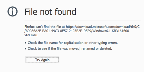

Have tried to install KB3168965 via Elevated command Prompt and Powershell but failed . I assume I have the command correct but have included a screenshot of the Cmd window.
I assume i need to edit the "User" but got a bit confused I'm afraid.

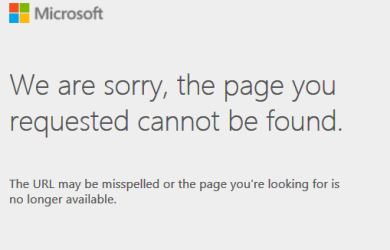

KB3020369 is installed but have tried both Firefox and IE and still get :

Try In-Private browsing on either ie11 or Firefox on the links.
Or clean boot you obviously have something interfering somewhere.
