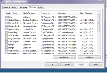

You could just quickly check in msconfig what you have starting at boot too I just keep security ticked (try first)
Start > type msconfig > right click run as admin > check the Start as in pic .

I did a disk check and everything was fine, I limited the startup items and it made no difference.
I also tried to boot in safe mode and it was super fast again. So how do I know eliminate the likely culprit?
