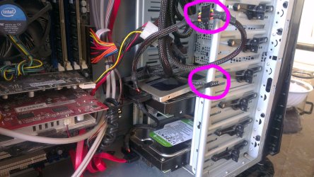

I think there is a power wire and data wire inline spare so hoping can just move c ssd drive up to front add second drive to 2nd inline and add 3rd drive to third position. Computer will rec os first drive which is c drive and boot up and then all i do is removed the old os files from the second drive and use it for data backup etc after format

so connect ssd to the 2 plugs as circled..

There seems to be 6 ports on the MB so you should be able to have 6 devices
win 8 32 bit
so go with my plan and just add c drive to first inline cable as circled in pink, and other hard drives after that?

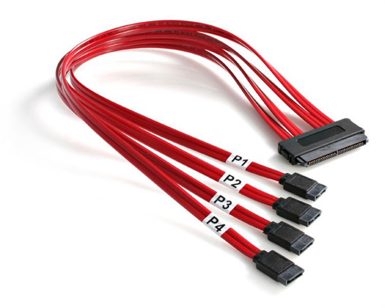

went to pc shop and needed a data cable. red one.
All I do it hook that into extra port and use power from that inline cable I speak about. Make sure c drive is using port 0 and should be good to go.

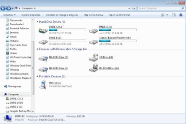

mmm the disk drive has signature collision with other drive so is offline...
Intel(R) Core(TM) i5-2400 CPU @ 3.10GHz
ASRock P67 Pro
8.00 GB
AMD Radeon HD 5670
(1) ASUS Xonar DX Audio Device (2) AMD High Definition Aud
(1) Crucial_CT500MX200SSD1 ATA Device (2) WDC WD10EZEX-08WN4A0 ATA Device (3) WDC WD20EARS-60MVWB0 ATA Device (4) Seagate Backup+ Desk USB Device
so right clicked and put it online and then reformatted it. Looking good...

just adjusted the drive letters so its logical and all went to plan!
yee ha
