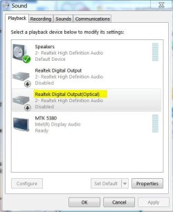

Shalom Yossi.
Right click the speaker icon in the lower right corner. Select Playback. In the window that pops up, check to see if Digital Output is enabled and selected as Default.

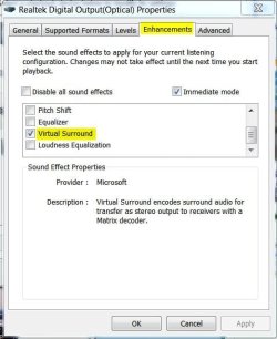

Two more screens to check.
The first screen is the Properties of the Optical output. Be sure the settings match your receiver.
The second screen is the Enhancement tab of the Properties. Check the box for Virtual Surround.
