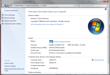

Hi All
I am guessing this is going to be a stupid question, so I do apologise in advance.
I have installed a full version of Home Prem 64 bit, but it only seems to want to detect 4GB of RAM. I only have 5GB installed at the moment, so it is not a great deal, but it is still confusing me.

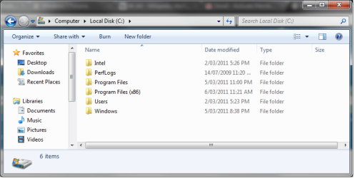

Another strange part is that although it seems to be a 64bit install it looks like it has been set-up as a x86 not an x64 system.
Does this make any sense?
I have attached a few screen shots to show what I can see.
Thanks for your help, and again sorry if it is an obvious one, I am new to 7.

Looks like this installed as X64 per your 2 screen shots. You will have 2 Program files in x64 !
The 1st is for the x64 programs & the 2nd (x86) is for 32 bit programs that run in the win7 64bit.

I see, so the reason I am not seeing the x64 program files, is because I have no 64 bit programs installed?. That make sense. But what about the 4GB of ram limit?

C:\Program Files\ is your 64-bit (x64) program file folder. The other one is labeled (x86) to distinguish itself as the 32-bit folder for installation.

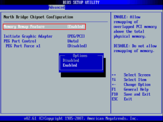

I have a PCI Express Sapphire Radeon HD5770 installed. And maximum memory is set to Zero. Could the problem be something to do with a bit of a mix and match of RAM? I have
2 * 1GB DDR2 @ 133MHz ( running duel channel I think ) ( I have had these for ages )
1 * 1GB DDR2 @ 200MHz and
1 * 2GB DDR2 @ 200MHz
Mobo is a Asus P5 B Deluxe if that helps any.
Possible the mis-matched memory :( Best to have all same Brand & Speed ;)
Also there is a setting in the Bios setup for Memory Re-Mapping that should be checked.

Your a legend.
That fixed the problem.
Thanks for your help Doc.
