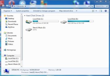

Here is a screen shot of "computer" showing the external IDE drives now as D and E ...this is because {nothing ever being easy} my netbook seems to have lost the screenshot/snip feature so I am now using another netbook.
C is my internal harddrive.
D and E are the 3.5" IDE
The D is accessible...E is not accessible...when trying to use the checkdisk feature in "properties", a message then says windows does not recognise the file [E]...I have tried this on several computers with the same result.

Hi chaps....note the perky difference ? I have managed to access the files in the drive...by entering into "properties" and looking there thoroughly(:o),came upon the security tab...it took a little messing around as I have never seen this before but eventually the magic words were inserted and it became accessible...I`m no techie and this may seem an obvious thing to do but not to myself I am afraid to say...however,I shall not forget...and am relieved to say the least as the files are important for some arrangement work I have.
Thanks for all the assistance that led me there guys ! :party:
