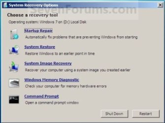

When your computer "takes you to system restore" are you saying it's automatically selecting a restore point for you to use or are you seeing either a restore screen or a recovery screen?
Have you tried to manually access System Restore to select a restore point of your own choosing (option one) to a date/time before the blond moment? :)

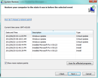

I tried to manually access System Restore to select a restore point but it only has till the 25th and the blond moment occurred 15 June '12.
Just to be sure, did you have "Show more restore points" checked?
See red box:

Yes I did tick it.
Have a look here.

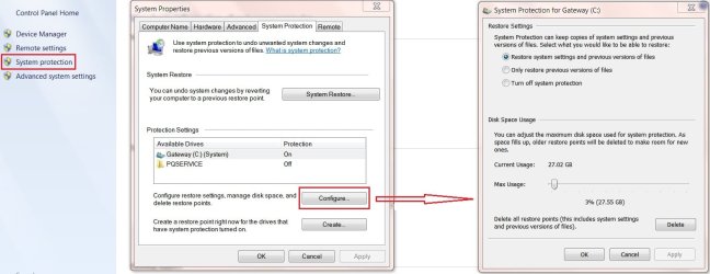

I recall that you did not have enough restore points:
As you have experienced, it would be in your best interests if you had more points to work with.
My general rule of thumb is to have enough points to overlap the previous months release of Windows Updates.
Currently I have 29 dating back to the 17th of May, 26 that deal with Windows Updates, and three with programs that I installed.
If you would like to increase the amount of points follow this tutorial: http://www.sevenforums.com/tutorials/335-system-protection-change-disk-space-usage.html
It should be noted that this increase will depend on how large your HDD is, mine is 1TB, and I have allocated 27GB to give me those 29 points.
With only six showing in your Snip attachment it would seem that you are only allocating maybe 8GB. I would at least double that, then use your machine at least until the next round of updates to see how many you now have in reserve.
It will take a while depending on the amount of activity on your machine, see information box here: http://www.sevenforums.com/tutorials/697-system-restore-point-create.html
Here is how I have mine set:
Oh! And don't forget to click on Apply, and then OK. ;)
