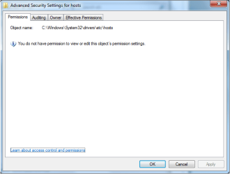

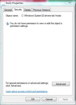

When editing permissions in the "Security" tab inside properties I messed up and edited my own to not be able to change the file anymore. Can someone tell me how to fix this.(this is a re-post because I posted in the wrong section before.)

The account I'm using is already administrator. I tryed "net user administrator /active:yes" in command prompt. Even that administrator account but is unable to change the security setting on the file. If I could go to a higher level of access I would but administrator is the highest state unless there is a higher one I am unaware of.

The etc directory is owned by "Trusted Installer", as a result I don't think that you'll be able to modify the permissions (i.e. add yourself back in again).
Do not remove "Trusted Installer". :eek:
If you remove "Trusted Installer", you won't be able to add it back in and that will cause trouble.
You might be able to restore your rights using icacls (Command Prompt) but I've never had any success using it.
I deleted "Trusted Installer" (when I was messing around with the W7 betas) and I was forced to restore Windows from my backup image.
It looks like you'll have to hope one of the experts can suggest a solution.
Sorry.

Try this, it resets all the Security Settings in Windows 7 to the defaults.
Start Menu - type in Search box -> CMD, then at the top - Right Click on - RUN AS ADMIN
Type or Copy and Paste this at the prompt :
secedit /configure /cfg %windir%\inf\defltbase.inf /db defltbase.sdb /verbose
Hit Enter.
Since you say you can easily restore if things go bad..........

Method 1.
You need to be logged in as Administrator for this method.
To take control of your system's hosts file, go to the properties, select Security tab, click on Advanced button in the bottom of the dialog box.
In the second dialog box "Advanced Security Settings for hosts" go to the Owner tab press "Edit" button.
You will see that the System account is the default owner of this file. Now take ownership of the file.
After taking ownership of the file you can change the permissions for any user listed there. You can also add new user account or delete existing accounts from the permissons dialog box. Set the permissions to your satisfaction and close all the dialog boxes by clicking OK buttons.
