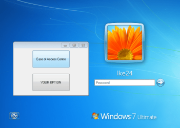

We have a unique situation that requires us to try and add a custom button to the logon screen of windows 7. We have searched all over for a solution but have been unsuccessful in finding an answer, the only thing we have found is using the Accessibility icon on the logon screen and replacing this with our executable that we need to run. However we have some users that require the accessibility feature so doing this does not work for us. Has anyone successfully created a custom button on the logon screen that would call to an executable such as cmd.exe?

If start of a script or program is voluntary, why do you want user to make a decision to start it at Logon stage? What changes when user have option to start it while inside Windows?
As for solution, looks like you only option is to replace Accessibility icon with an intermediate executable. What executable should have a window with two options - link or button to start Standard Accessibility features and link or button to start your script/program. This way you will get what you want and save Accessibility features (they just gonna be one click away from user).

Thanks Neutron16, the executable with the two different options as you mentioned would work for our situation. I am going to go ahead and try this option and see if that works for our users.

I got the script built to bring up a window as mentioned, however when I replace the Utilman.exe with my custom executable and then rename the original Utilman.exe to Utilmanmod.exe when you click on the Utilmanmod.exe it actually opens the Utilman.exe (custom script I created) instead of the Ease of Access. Is there something else i have to change so that when I click on the Utilmanmod.exe it opens the ease of access?

Yes, that happens when explorer or cmd.exe starts utilmanMOD.exe directly or your custom utilman.exe passes command to explorer or cmd.
HOWEVER, that does not happen when parent process is not explorer or cmd. Basically, if your custom utilman.exe starts utilmanMOD.exe direcly, you will see utilmanMOD.exe running
I do not have any compilators to try, but I have tried with some trainer makers and autorun menu makers.
I can PM you proof - exe that will start utilmanmod.exe
Then only problem I have found - is that utilmanmod.exe comes with no text at all, but you can fix it.
In C:\windows\system32\en-US (or your language here) make copy of utilman.exe.mui and rename it to utilmanMOD.exe.mui
