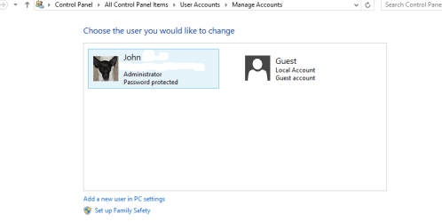

Hello and welcome Andrew now just what accounts do you have set up all I have is my main account (admin) and an account called Guest which I never use anytime.
I attached a pic of my accounts control does yours look the same?

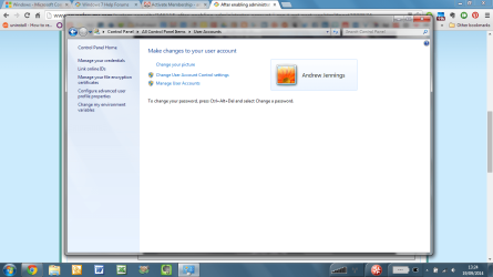

I can't get to "manage user accounts" as it requires user account control, which I can no longer authorise.
The furthest I can get is User Accounts
