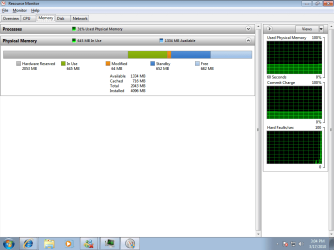

thats the pic of my ram

You attached picture shows you have 2 GB set aside for Hardware Reserved. Maybe something did happen when you ran memtest. How exactly did you run it?
I haven't run it but I notice it allows for a cache to be set aside. Does that number equate to the 2 GB?
