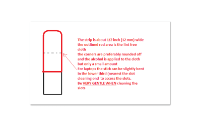

Ok mate just make sure the card is seated well and you might try cleaning the slot as well to ensure good contact. See my ditty on it
SLOT CLEANING
Now as for the slots to clean them use a strip of old credit card about 1/2 inch wide nip the corners off one end - preferably round them off hold a piece of thin lint free cloth over the end dab on some form of alcohol - isopropyl alcohol (what we swab the skin with before an injection) is good and GENTLY swipe along the slots.
This can also be done for the GPU slot/s and also the contacts of the sticks or cards - not the stick but some lint free cloth of course. See my pic for the sick but please be very gentle doing it if you are in any doubt - please ask before doing it but I use this all the time and have yet to damage anything.
